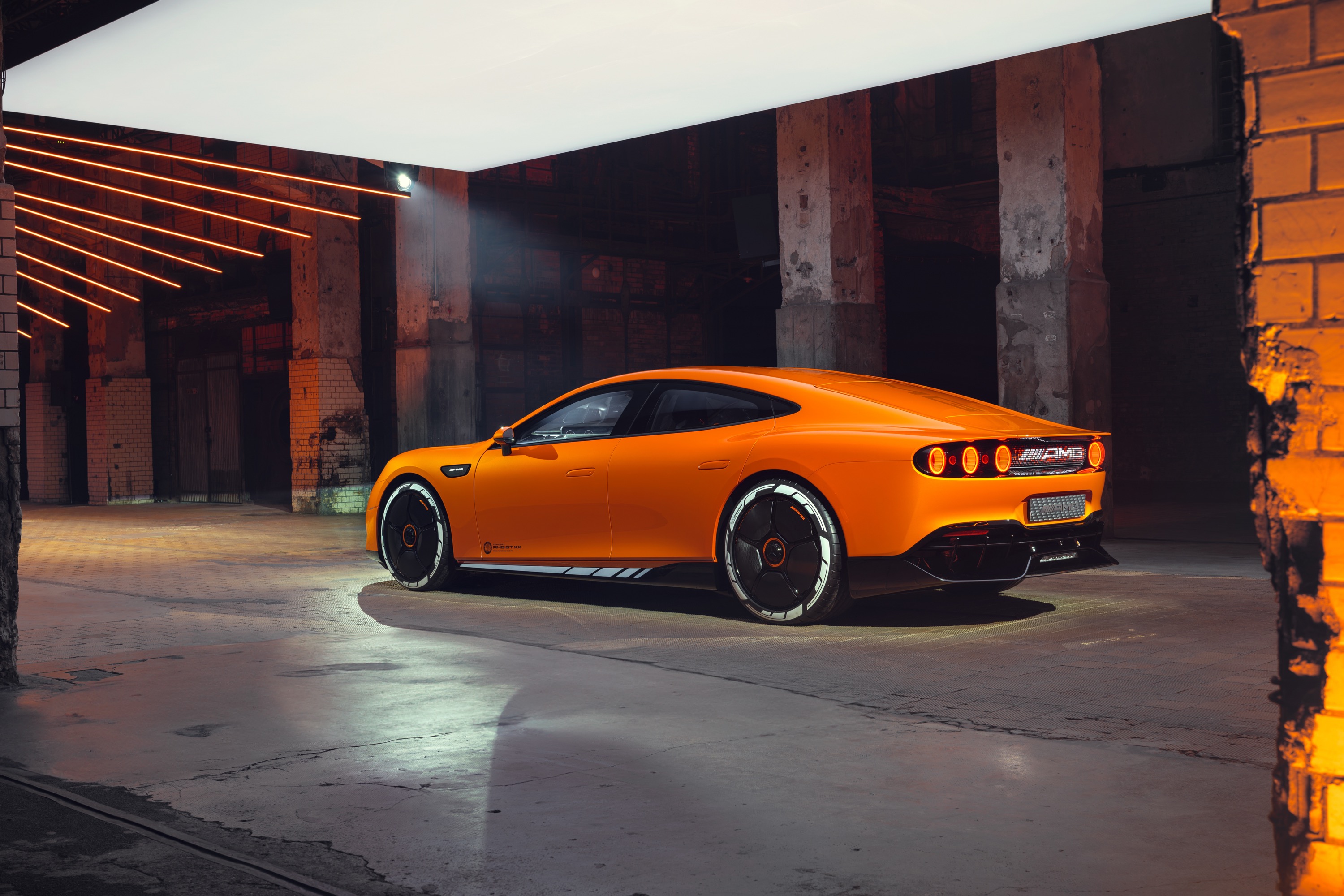

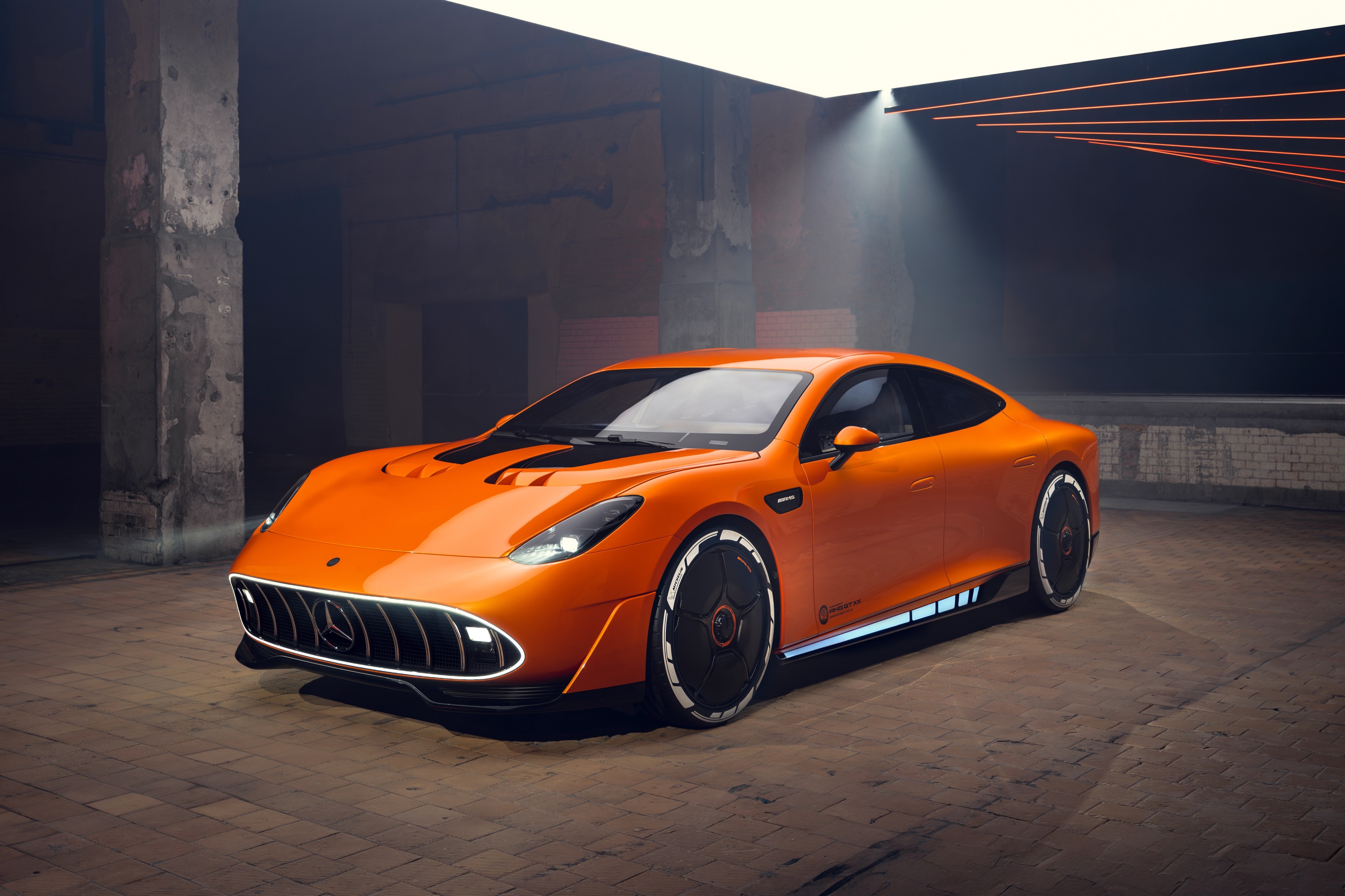

Mercedes-AMG presents the CONCEPT AMG GT XX. Mercedes-AMG

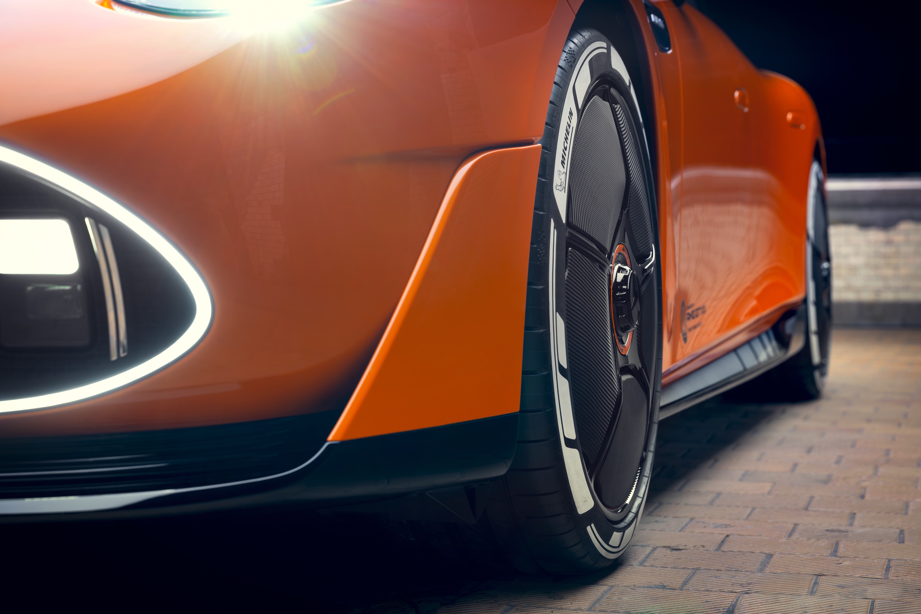

Wheel covers, closed. Mercedes-AMG
Wheel covers, open for cooling. Mercedes-AMG
