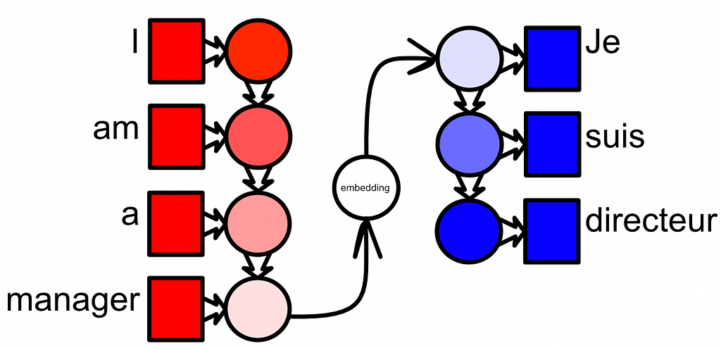

The encoder-decoder architecture in a nutshell, for a french to english translation task
This is a very common architecture, but the exact details can change drastically from implementation to implementation. For instance, some of the earlier literature in sequence to sequence encoder-decoders were recurrent networks that would incrementally “build” and then “deconstruct” the embedding.
Conceptualization of the information flow of a simple sequence to sequence recurrent encoder-decoder. The encoder incrementally embeds the english words, word by word, into the embedding space, which is then deconstructed by the decoder. In this diagram, the circles represent the embeddings throughout the encoder (red) the intermediate embedding space (white) and throughout the decoder (blue). In this case, the embeddings are long and complex vectors with abstract content which isn’t easily human interpretable.
This general idea, and minor variations therein, was state of the art for several years. However, one problem with this approach is that the entire input sequence has to be embedded into the embedding space, which is generally a fixed sized vector. As a result, these models can easily forget content from sequences which are too long. The attention mechanism was designed to alleviate the problem of needing to fit the entire input sequence into the embedding space. It does this by telling the model which inputs are related to which outputs. Or, in other words, the attention mechanism allows a model to focus on relevant portions of the input, and disregard the rest.
