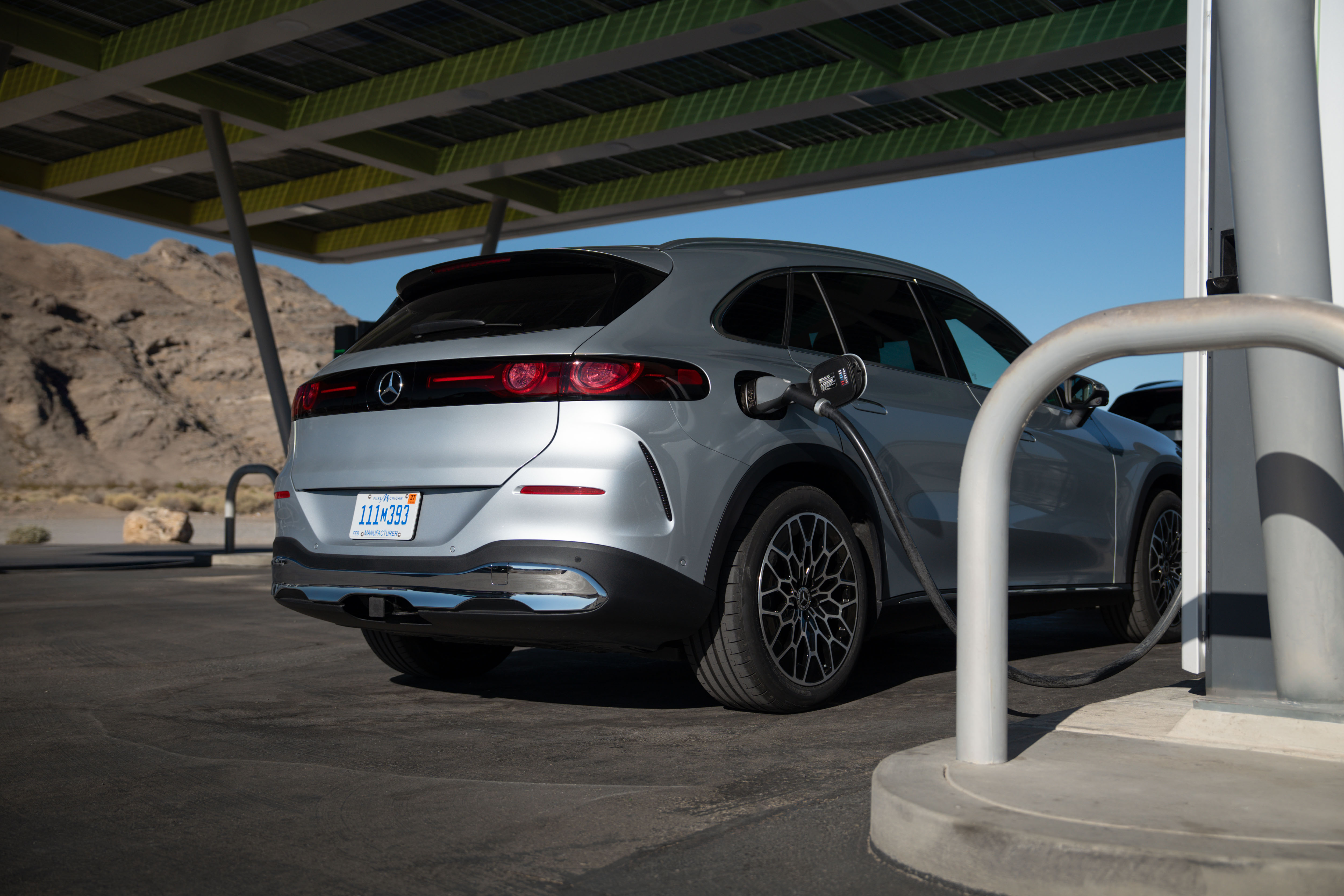

It should take as little as 22 minutes to charge the GLC's battery from 10 to 80 percent, charging at up to 330 kW. Mercedes-Benz

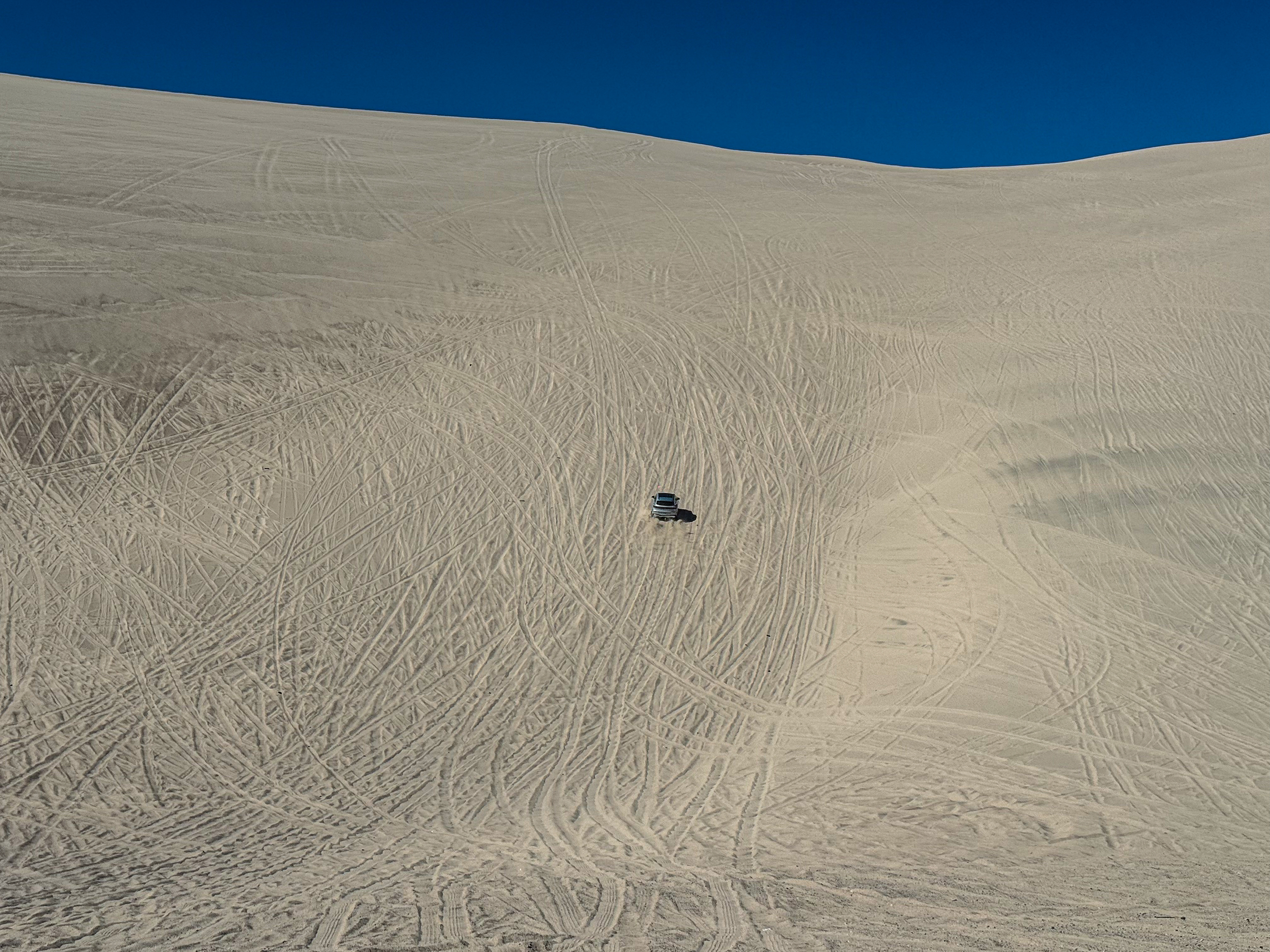

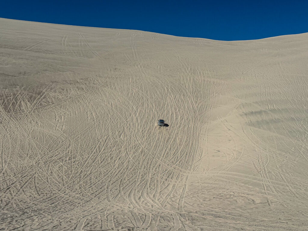

As I climbed a dune, my view was nothing but sand, then the deep blue sky. Despite the steep slope and the fact that the car was shod with regular street tires, the wheels found traction where needed, “churning” where necessary. Under braking, the ABS allows the front wheels to remain more controllable, taking into consideration any steering angle you have.
And that may be a lot, because as Lightning McQueen learned in Cars, to go left, sometimes you have to turn right. At times, crabbing up the side of a dune involved making progress with a fair amount of opposite steering lock.

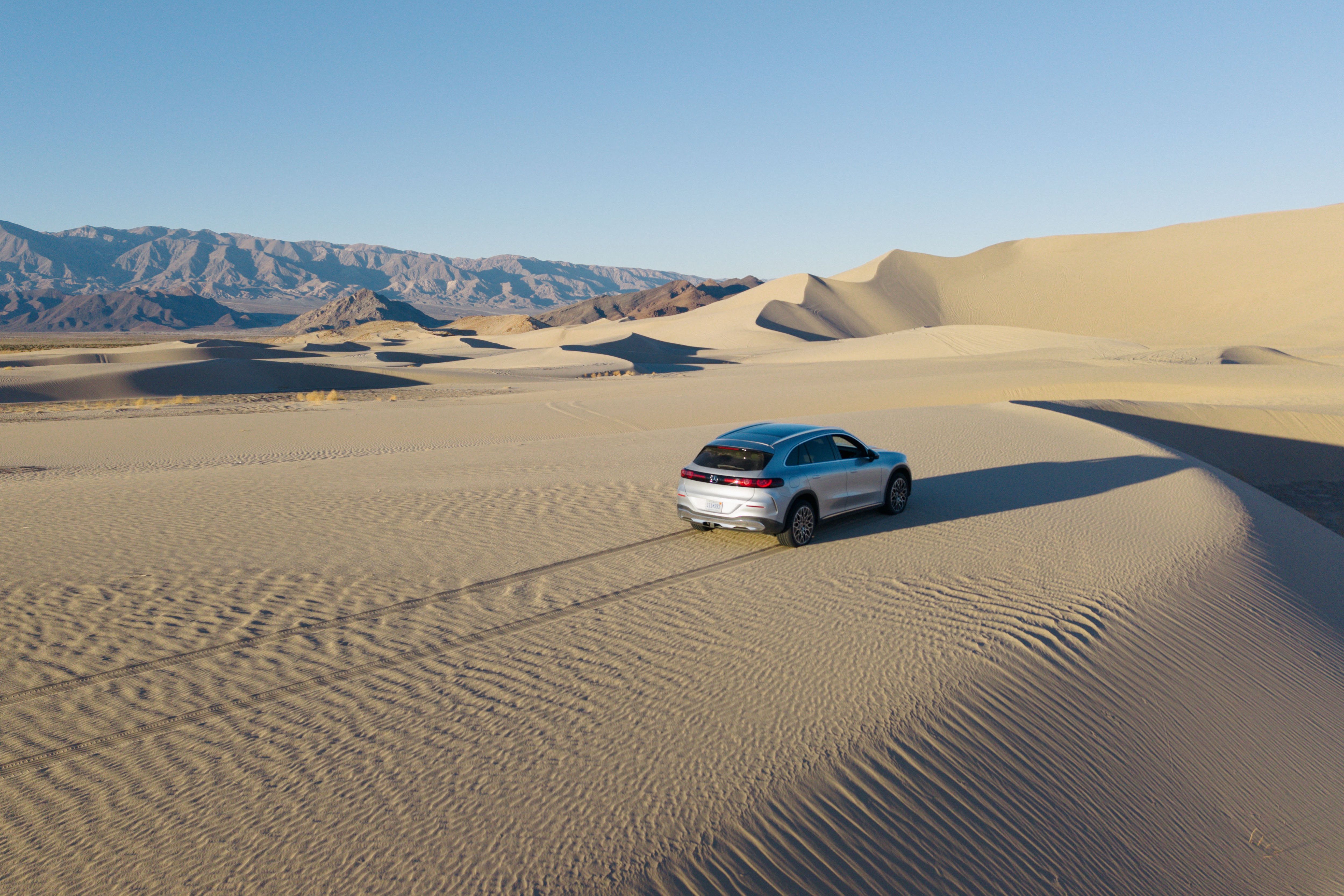

Driving on a loose surface like sand, similar to driving on snow, requires a fair bit of torque, and the GLC’s 596 lb-ft (808 Nm) was more than enough to throw a rooster tail or two as the speed picked up and propelled us along. And the low center of gravity that results from the 94 kWh battery pack between the axles no doubt helped keep the car planted even while driving sideways along the dune.
