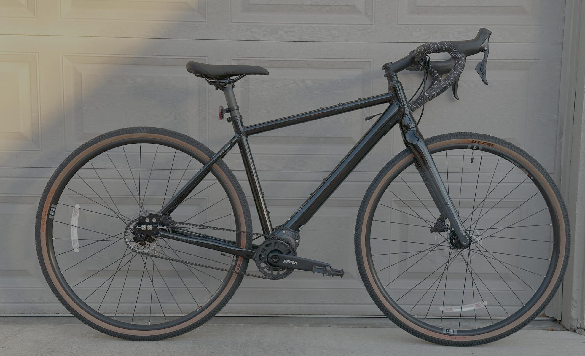

The Priority Apollo gravel bike eschews chains for a low-maintenance belt drive. Credit: Eric Bangeman
In combining a belt drive with a gravel bike, Priority Bicycles has put a smart idea into action with the Apollo Gravel. The execution is mostly there, although the Apollo is perhaps best described as a fantastic commuter bike with a solid gravel upside—as long as the road isn't too rough.
The Apollo Gravel comes in both aluminum and titanium frames. I tested the $1,999 aluminum model; the titanium version retails for $3,999. The aluminum version weighs in at 24 lb (10.9 kg), about a half-pound more than the titanium version, and comes with 40 mm WTB tires, WTB i23 ST tubeless-ready wheels (our test bike had inner tubes), and semi-hydraulic disc brakes. Both models use the Shimano Alfine 11 hub and a Gates Carbon Drive Belt, although our test model showed up with the Pinion Smart.Shift instead of the Alfine hub listed on the Apollo's spec sheet.
No mess, no fuss
At first glance, a belt drive and internal gear hub seem the perfect match for a gravel bike. But implementation is key, and Priority has largely nailed it. Regular gravel grinding means regularly washing your bike and lubricating the chain. While the Apollo got dirty and needed to be hosed off, there were no gloves or chain lube involved. There were also no worries about dirt and dust making their way into a derailleur or coating the cassette. Belt drives are also dead quiet and have an excellent reputation for longevity, lasting up to three times longer than a chain.
No mess, no fuss
