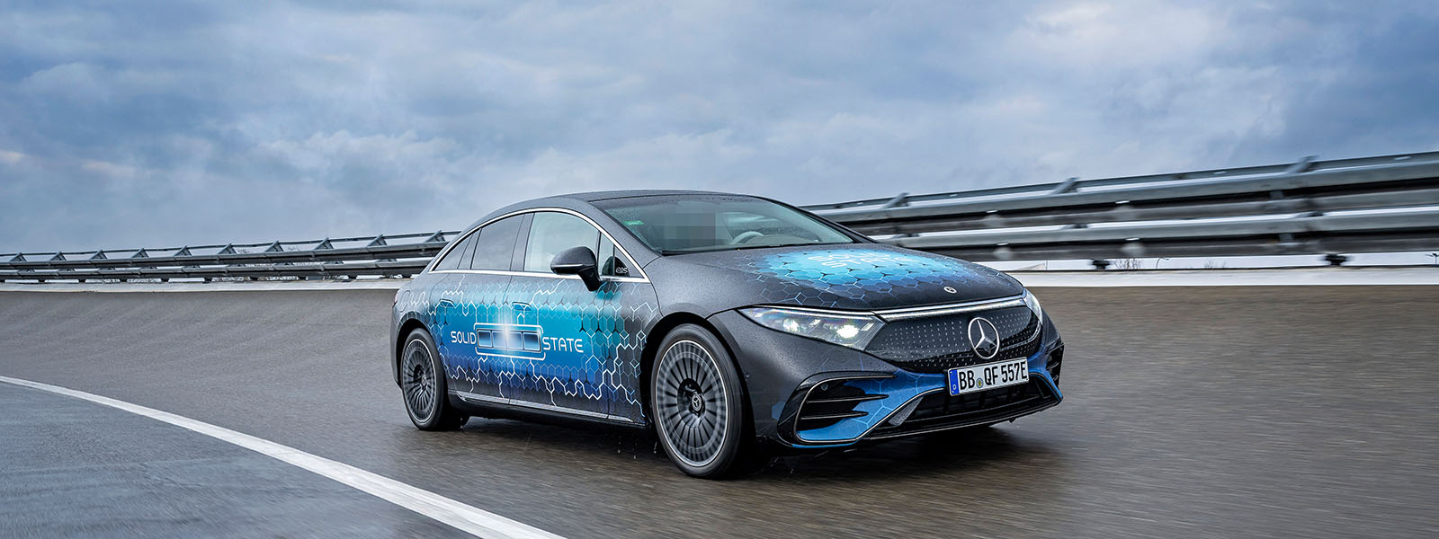

In early 2025, Mercedes-Benz ran its first road tests of an electric passenger car powered by a prototype solid-state battery pack. The carmaker predicts the next-gen battery will increase the electric vehicle’s driving range to over 620 miles (1,000 kilometers). Credit: Mercedes-Benz Group
