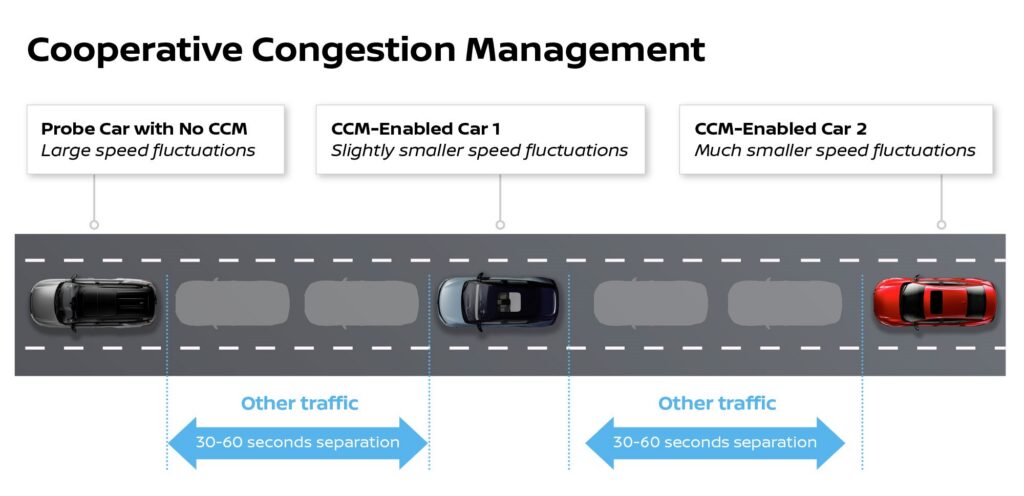

Instead, CCM works by having a lead car, or "probe," send information to following CCM-equipped cars, which are separated by non-CCM cars between them. The information from the probe car lets the following cars keep an appropriate distance from each other—between 30 and 60 seconds—and if there's a slow down ahead, the following cars will decelerate more gently over time, preventing the kind of concertina action that triggers traffic jams when human drivers see someone slowing down in front of them.
Jerry Chou, a senior researcher at Nissan's Silicon Valley center, described CCM to me as "mixed autonomy—that means a mix of the controlled vehicles and other human driven vehicles in between." Instead of DSRC, the cars use their embedded LTE modems to communicate via Nissan's cloud.
As most people who have used adaptive cruise control know, if your following distance is too large, other drivers will often cut in, causing you to decelerate. "So we did spend some time to balance this phenomenon and the performance of our system. So there's some parameters we continue to control to balance this," Chou told me.
