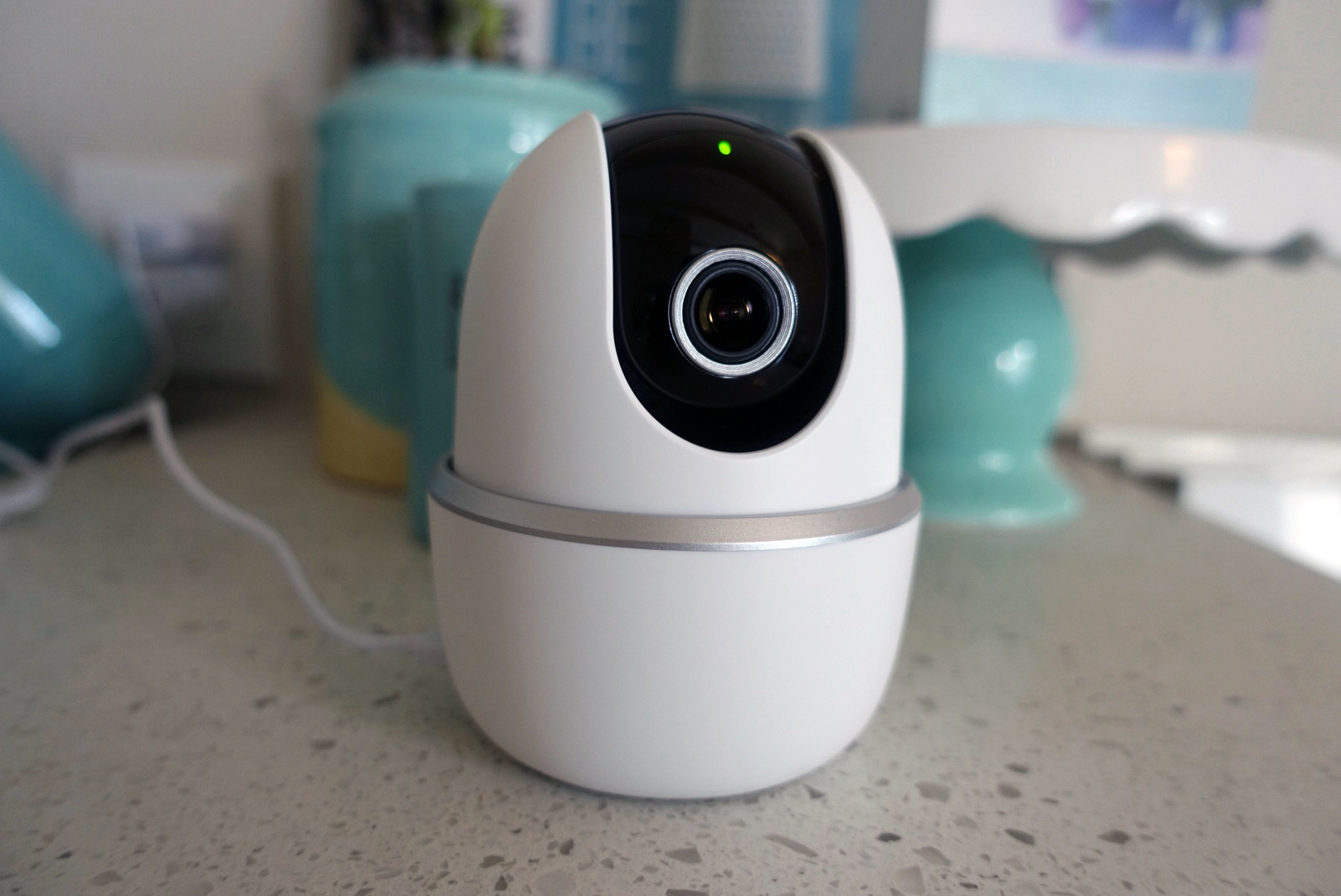

Budget-friendly cameras often rely solely on infrared for night vision, and many do it well. Models like the Eufy Security Indoor Cam and Lorex 2K Indoor Pan-Tilt Wi-Fi Camera offer strong IR performance, providing crisp and clear footage when the lights go down.
