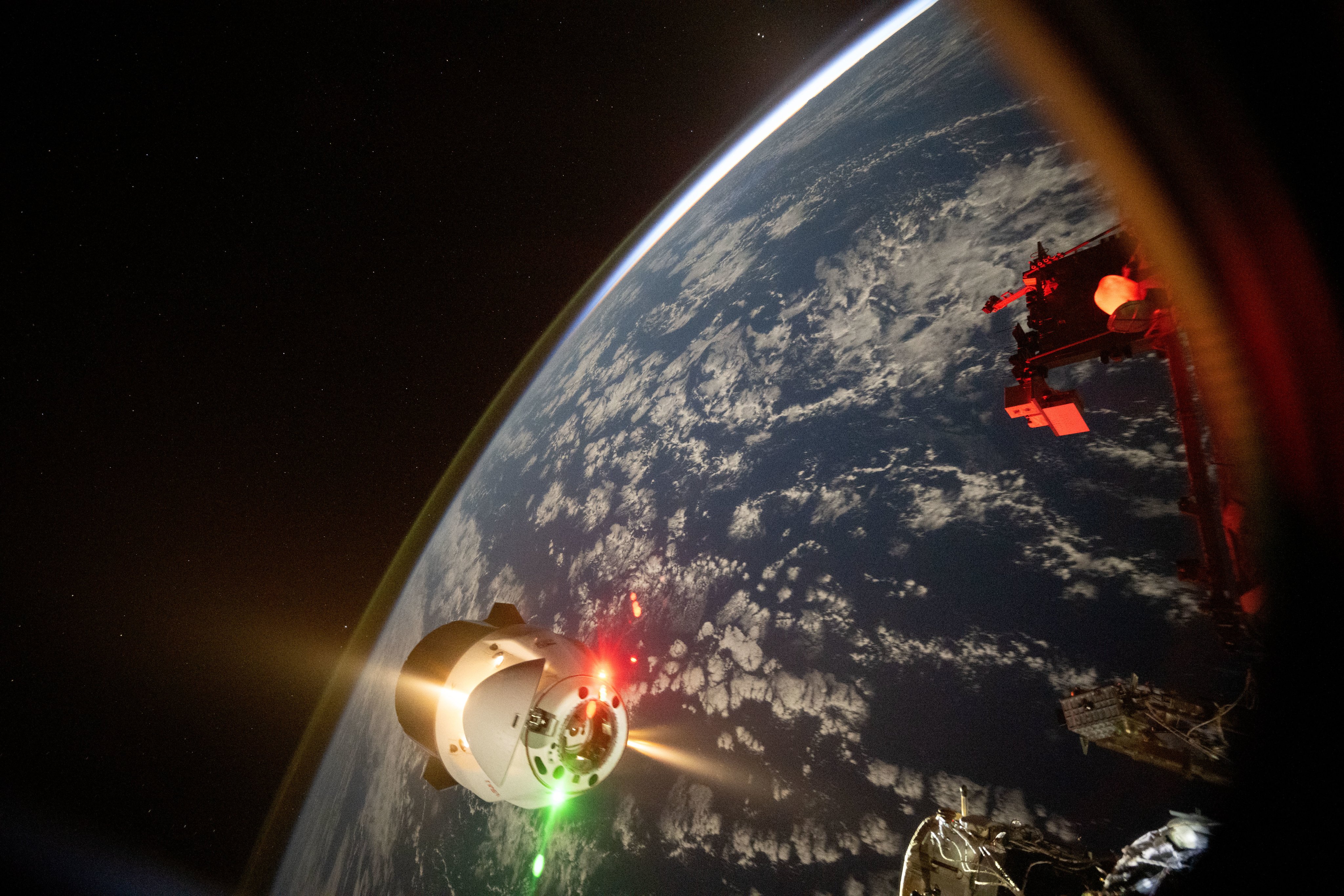

File photo of a Dragon spacecraft firing its thrusters near the International Space Station. Credit: NASA

In low-Earth orbit, thrusters raise the station's altitude by adding a small amount of velocity to the lab as it circles the Earth at more than 17,000 mph. The Cygnus spacecraft compensated for its suboptimal position on the ISS by using its steerable main engine, using gimbals to move the engine's nozzle to direct its thrust in the right direction.
SpaceX's Dragon cargo vehicles, on the other hand, are able to dock at the forward end of the space station's long axis. Theoretically, this would make it easier for Dragon to boost the station's orbit, but SpaceX must set aside enough propellant for the spacecraft to travel up to the ISS and then return to Earth at the end of its mission. Dragon's 16 Draco thrusters are also not steerable, but SpaceX demonstrated they could make small adjustments to the station's orbit last year.
