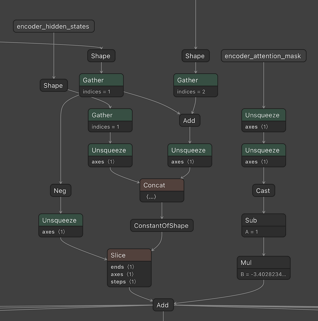

There are several ways to represent model architectures as graphs, and here I review just a few categories. First, there are code machine learning compilers like GLOW, MLIR, and Apache TVM. These can compile code like PyTorch code into intermediate representations that can take the form of a graph. TensorFlow already has an intermediate graph representation you can visualize with TensorBoard. There’s also an ONNX format which can be compiled from an existing saved model, e.g., using HuggingFace, as easy as:
optimum-cli export onnx --model google/flan-t5-small flan-t5-small-onnx/
This ONNX graph serialized looks something like (small snippet):
Image by the author

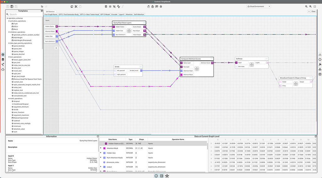

One problem with these compiled intermediate representations is that they are difficult to understand at a high level. An ONNX graph of T5 in Netron, is immense. A more human-readable option for model architecture graphs is Graphbook. The free-to-use Graphbook platform can show you the values being produced by each operation in the graph and can show you where tensor shapes and types don’t match, plus it supports editing. In addition, the AI-generated model architectures may not be perfect, so having an easy way to go inside and edit the graph and troubleshoot why it doesn’t work is very useful.
Example view of Graphbook graph, Image by the author

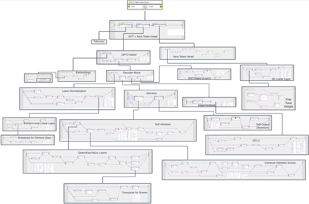

While Graphbook models are just JSON, they are hierarchical and therefore allow better levels of abstraction for model layers. See below, a side view of the hierarchical structure of GPT2’s architecture.
Image showing the hierarchical structure of Graphbook graphs, with GPT as example here. Full image: https://photos.app.goo.gl/rgJch8y94VN8jjZ5A, image by the author
