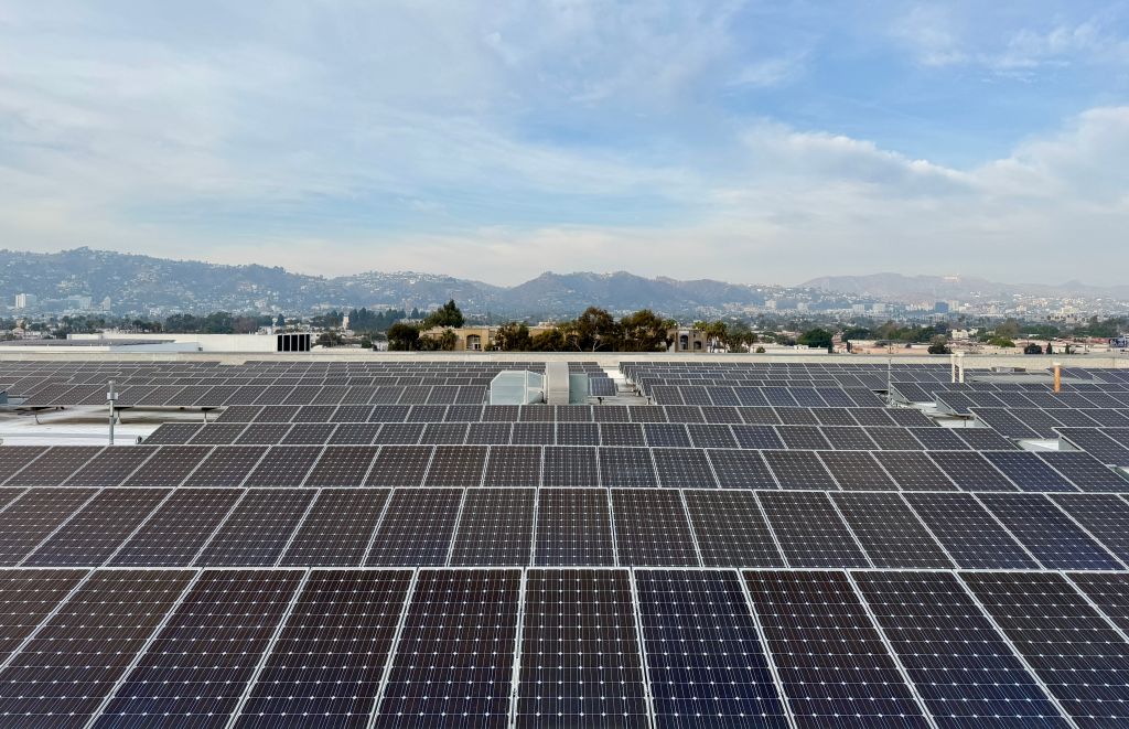

Half of a year of data shows that the solar boom is not slowing down.
Credit: DANIEL SLIM
