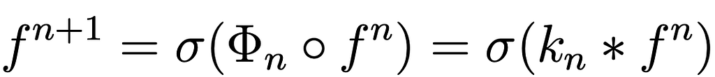

We can define the convolution as following:
Eq.8: Top: Relation which connects layer n and layer n+1. Down: Definition of convolution in the space S
The top equation Eq.8 represents the function which connects the layer n and n+1; the one below is the definition of convolution in n-dimensional space S. The function σ(x) represents the non-linear function applied at the output of the convolution.

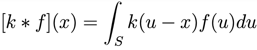

In Fig 2B, it is possible to see how, in a discrete domain, the convolution between the kernel and the input layer is calculated.Let’s illustrate this with a grayscale image denoted as f ₀: ℝ² -> ℝ. We can apply the filter discussed in Section 2, which was a steerable filter with the function
k(x₁, x₂) being a 2D Gaussian filter defined as k: ℝ² -> ℝ¹˟¹=ℝ.
In this case the application of the filter k on f₀ is the classical 2D convolution and it can be written as:
Eq.9: Definition of convolution

- NN Filters φn: A filter can be defined as a map between two contiguous layers in this way so φ:Fₙ→ Fₙ₊₁. The application of such a filter to a layer implies the convolution with the respective kernel k. How the convolution is defined in this case is crucial to the understanding of steerable NN. For this reason we dedicated a paragraph below.
In this case, the kernel can be seen as a function k: S → ℝ ͨ ʿⁿ ʾ ˟ ͨ ʿⁿ⁺ ¹ ʾ, where each position in S is connected to a matrix of dimension cʿⁿ ʾ ˟ cʿⁿ⁺ ¹ ʾ. For clarity, cⁿ and cⁿ ⁺ ¹ are respectively the dimension (number of features) of Fₙ and Fₙ₊₁.
