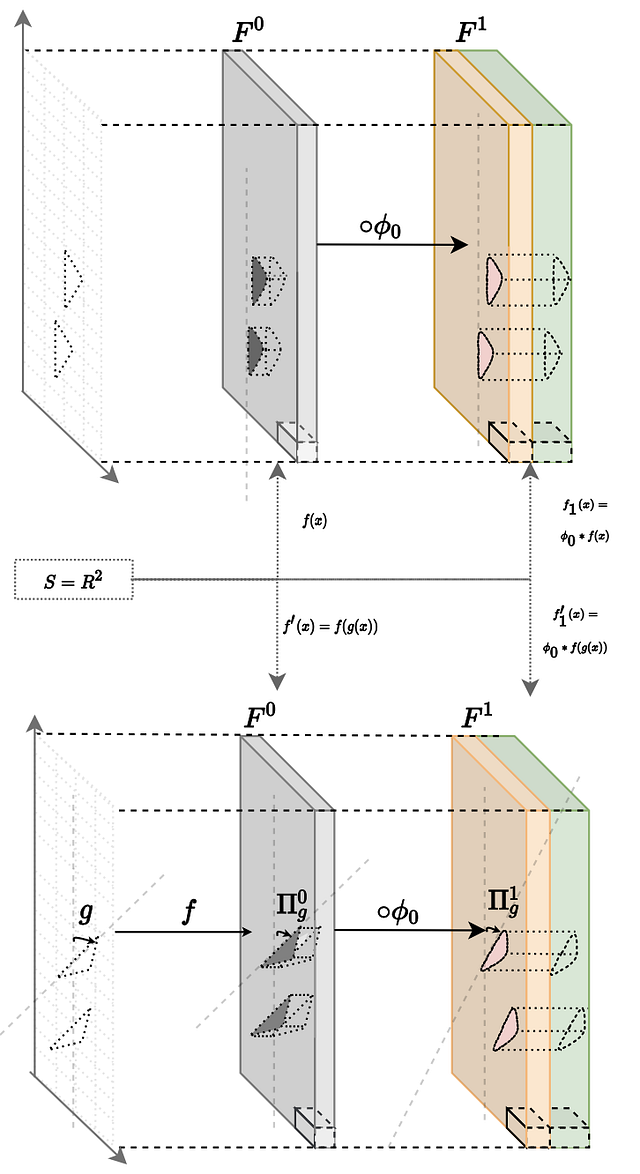

Fig3A: Visual example of equivariant CNN filter. Given the transformation g acting on S and the consequent rotation of the input signal f given by Π₀(g), f1 is rotated by Π1(g).

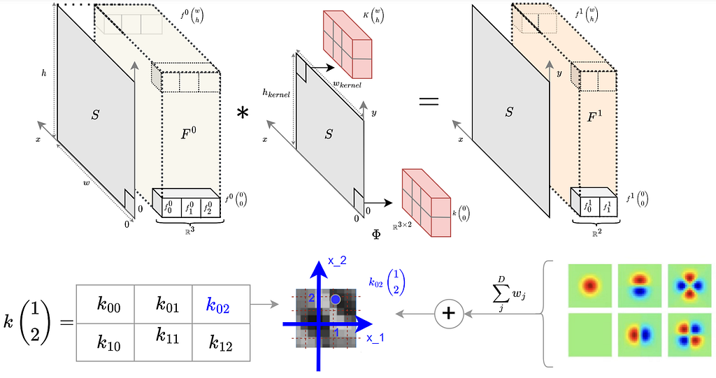

Considering a more filter design scenario, in the image Fig 3C below, we see for example how an SO2 steerable equivariant kernel is built for a input layer f ₀: ℝ²->ℝ³ and an output layer of f₁:ℝ²->ℝ².
The kernel is a function k: ℝ²->ℝ³ˣ². Each single element of the matrix is obtained from a function resulting from the linear weighted combination of the D basis sampled at the position (x₁,x₂) . We see the example above for position x=(1,2).
As follows we will show some simple solutions of this equation considering , S=ℝ² and G as group of rotation transformations impling SO2 networks.
Fig 3C: Visualization representation of a steerable kernel 3x2 is built using a basis of 6 harmonic functions.
